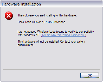

This page should only be needed if you encounter the following message when trying to install USB drivers:

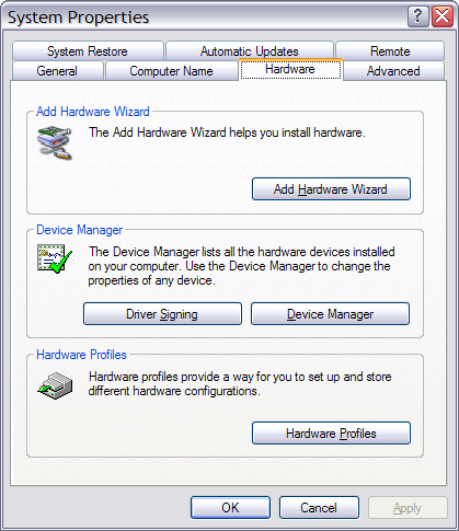

To resolve this problem, first make sure you are logged in as the Administrator. Unplug the Interface from your PC.  Next, go into Start -> Control Panel -> System and click on the Hardware Tab as shown below.
Next, click on Driver Signing and the dialog below should pop up.

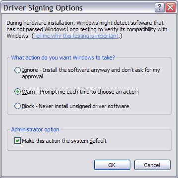

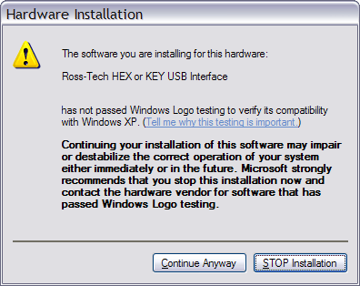

Select the radio button for Warn and click OK. Next, plug the Interface in and follow the prompts on screen for the Found New Hardware Wizard. Now, this message should come up, you should select Continue Anyway:
