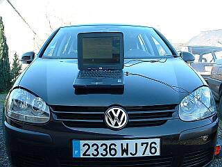

A 1K Chassis Golf-5 connected using a prototype
HEX-USB+CAN Interface -- February 2004
