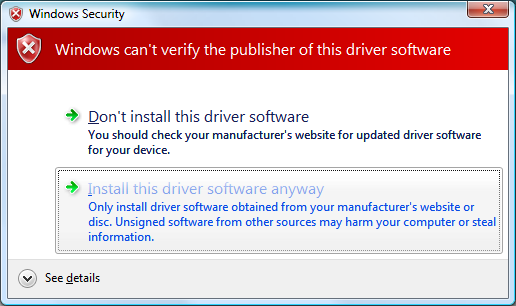

Once Windows Vista finds an appropriate driver, it will begin
installing it and present you with the following dialog:
Here it would seem that Microsoft has a terminology problem.
This dialog appears even when we sign our drivers with a
Class-3 Software Publishing Certificate from Verisign and the
appropriate cross-certificate from Microsoft, which should
according to all available documentation allow Windows to
verify the publisher (Ross-Tech, LLC).
We believe that the message actually means is that the drivers
haven't been WHQL certified by Microsoft something which is
the case because it's an expensive hassle.
In any case, you must click on "Install this driver
software anyway".
