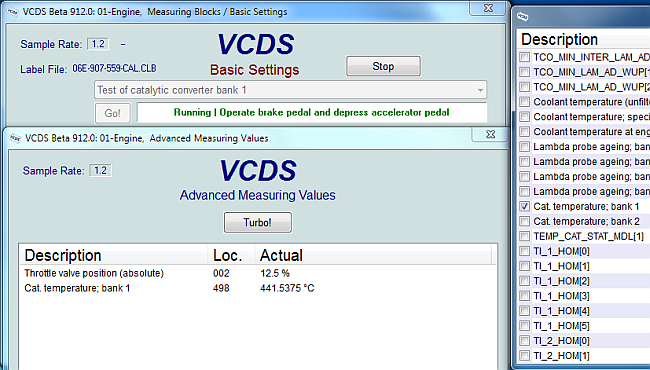

Basic Settings for latest Control
Modules using UDS/ODX/ASAM
protocols.

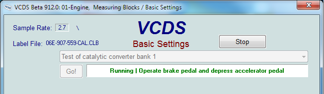

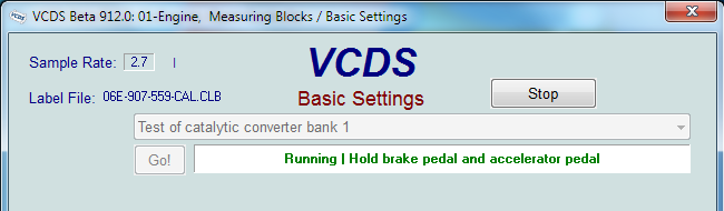

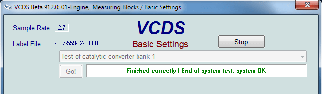

As is the case for other functions under UDS, there are no longer any channel or group numbers.
Instead, the Basic Setting to be performed must be selected from a drop-down list:
On UDS control modules which offer "Instructions", VCDS will
automatically display them:
In addition, UDS Measuring Values can be displayed simultaneously:
Added ability to view Measuring
Values during UDS Output Tests. This can be handy to
verify that certain outputs are functioning as intended:

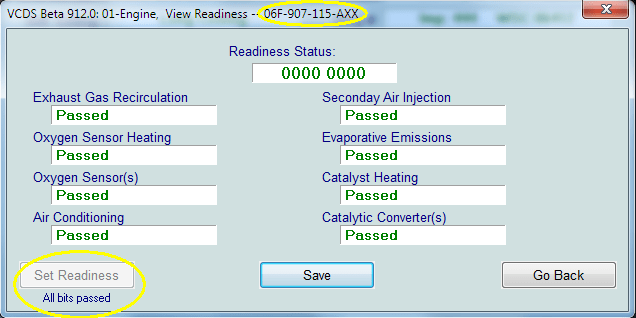

Improved Readiness screen, now
shows name of script in title bar and under [Set Readiness] button,
or gives a reason why [Set Readiness] is disabled when that is the case:
