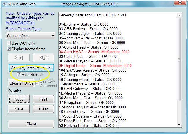

Optional Auto-Refresh for Gateway
Installation List.
Handy because it can show when a fault code appears in a
particular system.
