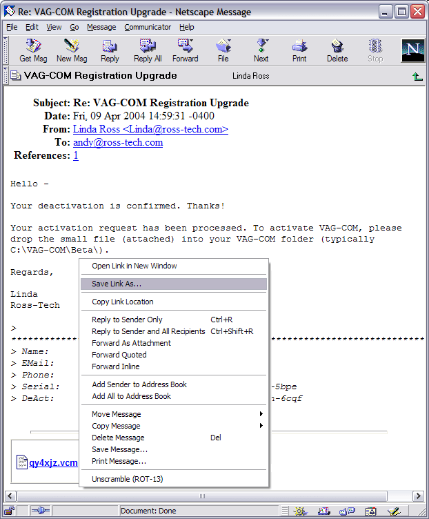

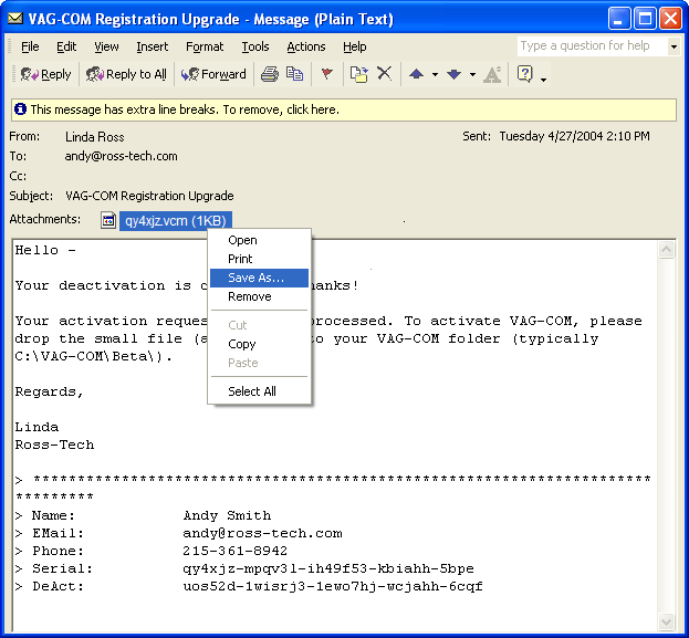

Once you receive the email with Activation File, make sure that the
Serial Number in the email still matches the Serial Number as shown on
the About Screen in VAG-COM. Use your email program to save the
attachment as shown in the examples below. If your email program does
not display the file as an attachment (may happen with Hotmail
accounts), reply to the email and ask for further instructions.
![](screens/4090/4091regemail03.png)
- OR -
![](screens/4090/4091regemailoutlook01.png)

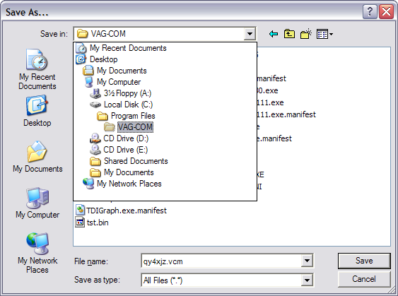

Save the attached
Activation file to your C:\Program
Files\VAG-COM folder as shown below:
(Make sure the "Save as type:" field at the bottom shows "All
Files (*.*)"
![](screens/4090/4091saveasb.png)
